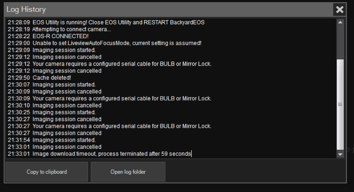

Ok , tested EOS Utility and worket perfectly in bulb mode via pc . As soon as the pic is taken it opens with DPP as it should do ... so the camera its ok , cable its ok , comunication its ok...
Tested right after that on BYE and in bulb mode:
"21:30:09  Your camera requires a configured serial cable for BULB or Mirror Lock.
21:30:10  Imaging session cancelled"
On Manual mode , 5 sec exposure keeps freezing me the software without doing anything (the camera didn't do any exposure)

You must make sure that both the Display and the Background parts of EOS Utility are Terminated (use TaskManager), as it keeps the background connection to the DSLR Open...
And, as always:  Send Guylain the Log File!
