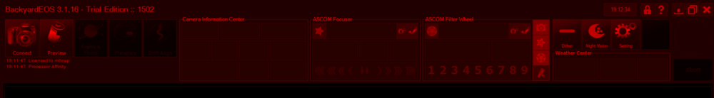

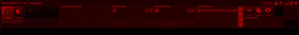

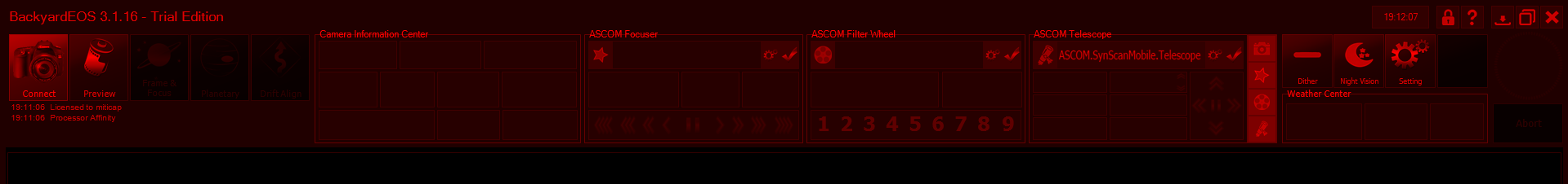

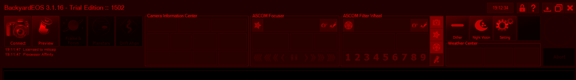

Hi,
I install new my notebook with all drivers and software (ASCOM, Drivers for may telescope etc.). I try to install BackYardEOS Trial and the section of Ascom Telescope no longer appears ... I hope this is not a problem :( and do the same after buying it.
