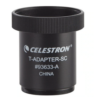

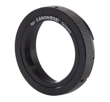

Jacques, I believe that all you need are a T-adapter and a Canon T-ring The T-adapter attaches to the visual back of the C 9.25 optical tube, the T-ring screws onto the end of the T-ada

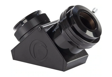

Jacque, I re-read your post and saw that you had also asked about using 2" eyepieces. In order to use your SCT with 2" eyepieces you need to purchase a 2" diagonal to replace the 1.25" diago
