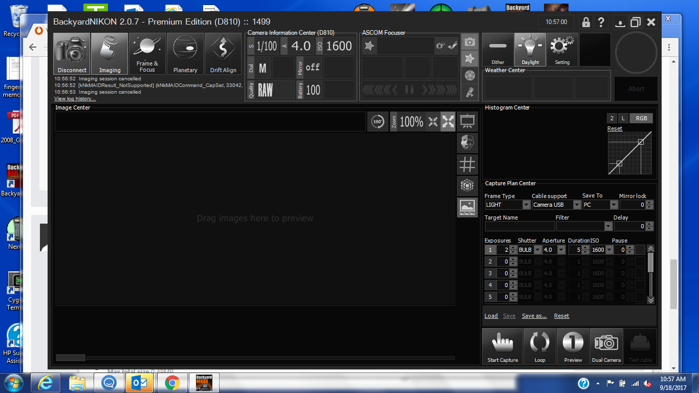

Just tried my D810 with 2.0.7 and still get the following:
10:56:26  Licensed to geothomas
10:56:40  Attempting to connect camera...
10:56:40  Nikon/D810 drivers initialized.
10:56:44  D810 CONNECTED!
10:56:51  Imaging session started.
10:56:52  Imaging session cancelled
10:56:52  [kNkMAIDResult_NotSupported] (kNkMAIDCommand_CapSet, 33042, kNkMAIDDataType_EnumPtr, 304735976)
10:56:53  Imaging session cancelled
From the image your dial is set to manual and you shutter speed is set to 1/100, not BULB.  Do these cameras have a BULB dial mode separate from M?  If yes this is probably why.
Keep us posted.  This seems to be a dial mode issue.
Verified the camera is now in bulb mode. Still see same issue. I just installed BYN and .Net 3.5 into my brand new desktop computer for first time ever. I connected my D810, powered on in Manual Bulb mode and same exact problem except it didn't even go the 5 sec for the first picture and now it won't do preview mode either.
