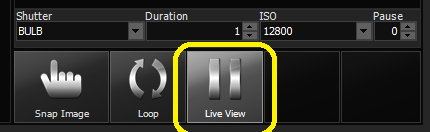

I can connect the camera to BYE 3.2.2. I then go to frame and focus while I align my telescope using the frame and focus and zoom box windows. exactly 30 minutes later I hear the camera mirror close and I then start getting a "13:58:35  Parameter is not valid." error

I the software then locks up and I have to use the CLOSE WINDOW option. I then have to unplug the camera and turn it off. connect the camera to the computer and turn the camera on. and restart BYE 3.2.2.
It will not reconnect using the LIVE VIEW button. I can take an Image from the IMAGING center. but I can return to the frame and focus but the mirror stays down and I cant see anything.

That is a safety feature built into the camera by Canon to prevent damage to the sensor due to prolonged use of LiveView. There is nothing that BYE can do to prevent it. Nor can the 30 minute timer be changed.
It should not take more than 30 minutes to focus and align your scope. I know several users who use LiveView for focusing and alignment and the 30 minute shutoff limit is not a problem for them. Also, you can pause LiveView when you are not actively using it. Then resume it when you need it.
Well, New scope 14" LX600, Polar Mounted on new pier. New camera, new software, new alignment process. Yea it takes me a few minutes to get it aligned right now.  I will do some more testing. Maybe if I leave LIVE VIEW between operations and go back to it. I can make it stay on. I will test. Thanks for the information. This was driving me crazy.
