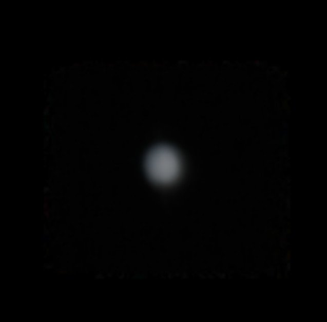

Hi. Can anyone give me the basic camera and BYES settings for capturing Saturn and its rings in Planetary mode? I've been trying for three months to capture Saturn's rings but all I've been able to capture is a white blob. The rings are not showing up unless I use very long exposures like one minute or very high ISO, which blows out Saturn itself. And even with very long exposures and high ISO, the rings barely look like like rings. They are mostly blown out. I use an 8" SCT and either a 2x or 3x barlow or even 25mm eyepiece projection. But none of them are showing distinct rings of Saturn. Thanks.

First, how are you focusing the telescope? Since the sky is all effectively at infinite distance you should critically focus on a star first, then slew to Saturn (or other target). Second, Planet

As Rick says, your immediate issue is Focus. And his suggestion of Focusing on a Star - select a moderate-brightness Star so you don't have to deal with Star Bloat - is the best trick. Since you
