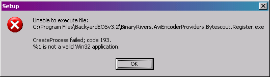

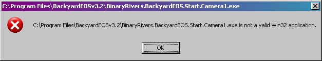

Two screen snaps attached...
One is the error that occurs right near the end of the installation process. Note the 193 error code.
The other is the error when I attempt to launch the app ('cause the installer did complete! placing the icons on the desktop--which is another subtle bug in itself).
