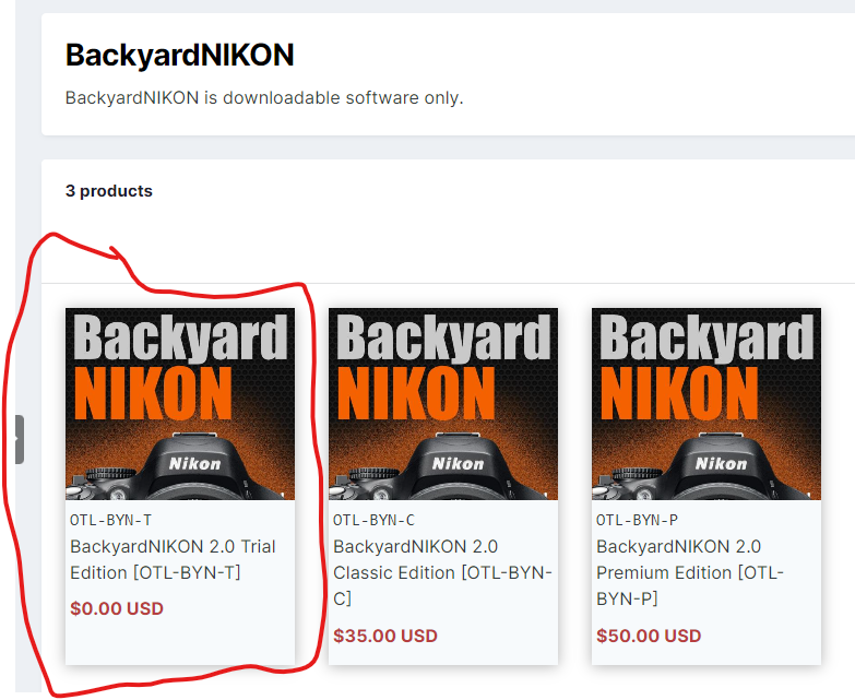

O'Telescope offers a free, fully-functional 30-day Trial license to give you the opportunity to test that your cameras are able to connect and to give you time to become familiar with the program before purchasing a permanent license. I am not sure why you bought a copy before testing that it would work for you. Once you have the permanent license, there is no way to return it so they cannot offer a refund of the purchase price.

I couldn’t find the option for. Trial so I went on and purchased. I have used my camera with Nikon software on this computer once before so I don’t think it’s a pc issue but I will check.
