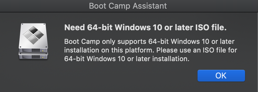

I have a Macbook Pro with MacOS Mojave installed.
I got Boot Camp up and running, and installed Windows 10. I was hoping to get my 5D mkII running with my laptop.
After trying to run BYE, I realized that it only runs on 32 bit Windows with the 5d. I believe I understand why (googled it.)
I downloaded the 32 bit ISO of Windows 10 and tried to install it using the Boot Camp assistant, and learned that it's not possible to install 32 bit Windows on MacOS Mojave. MacOS Mojave only supports Windows 10 64 bit:
https://support.apple.com/en-us/HT204048
https://support.apple.com/en-us/HT201468
Will I have to downgrade my MacOS in order to be able to install a 32 bit version of Windows, so that I can still run MacOS and Windows on the same Macbook Pro and use my 5D with BYE? I've tried to find the answer to this on this forum, and on Google, and a few other astrophotography forums, and I can't find anything.

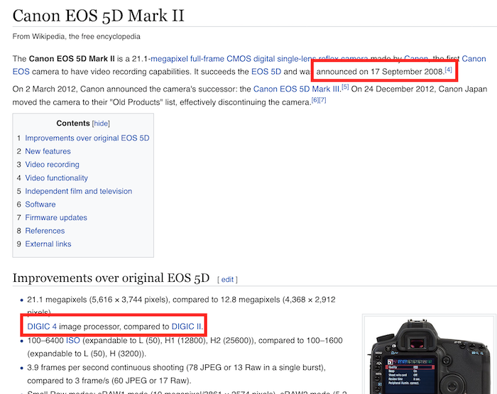

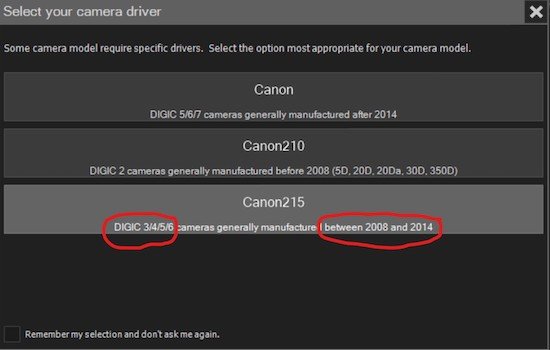

I might be speaking without having enough knowledge, but I worked on this project (getting BYE to work on with the 5d mkII on Mojave with Bootcamp/Win64) for about 12 hours yesterday, and at least half of that was research time. Had I seen the camera compatibility chart, that might have solved my problem earlier, but not for sure, though, as it seems that the in-app documentation/text is incorrect.
When I fired up the app and tried to connect to the 5D mkII, I saw this screen, and noticed the highlighted details:
When I search the internet to find out when the 5d mkII was manufactured and which DIGIC processor it has, I found this:
After seeing that, I tried the Canon 215 drivers in BYE, because that's what appears to be correct. That didn't work.
Then I tried the Canon 210 drivers in BYE, because it specifically says "5D" in BYE next to the 210 drivers (although admittedly note the mkII). That didn't work, either.
I didn't even try the "regular" Canon drivers (the top of the list in BYE) because it reads "DIGIC 5/6/7 manufactured after 2014"...which is definitely not the 5D mkII.

I didn’t bother trying “Canon” for the reasons I stated above, in my second post. If you look at that post, you’ll see that the 5D mkII was built in 2008 and uses Digic IV. The in-app instructions in BYE are clear...for a camera that uses Digic IV and was manufactured between 2008 and 2014, use Canon 215 drivers. I thought it was a stretch to even try the 210 drivers, since the in-app instructions mention 5D (although not mkII).
I always assume that in-app instructions are clear and correct, as they almost always are, so why would I even try the drivers for cameras with Digic 5/6/7 that were manufactured after 2014? There’s nothing about the 5D mkII that matches that description, other than “it’s a Canon camera”.

I agree that the labeling can be misleading, but you may have mis-read the release date of the 5D Mk II. It was announced as the successor of the original 5D in 2008, but was not released until March 2012. That said, your camera should be supported in the 2.15 version of the SDK, unless you have had the firmware upgraded. Upgraded firmware may require a version of the SDK that is newer than the release date of the firmware.
What those labels actually mean are the following:
Canon 210 - EOS cameras that were supported in the 2.10 version of the Canon SDK. This includes cameras that were supported when that version was released (March 2011), as long as they have not had a firmware upgrade.
Canon 215 - EOS cameras that were supported in the 2.15 version of the Canon SDK. This includes cameras that were supported when that version was released (September 2014), as long as they have not had a firmware upgrade.
Canon        - EOS cameras that are supported with the most recent release of the Canon SDK that is included with your version of BYE. For BYE 3.1.17 RC2 includes version 3.6.30 of the SDK that has a release date of July 2017 and works with all models that were supported as of that date.

There are definitely too many models to fit in the driver selection dialog, but I think the problem can be fixed by just saying "There are is a large combination of cameras, firmware releases, and drivers. If one driver selection doesn't work, try the others."
The entire documentation seemed to be very meticulous, leading me to believe that there just wasn't any way that it could be the "Canon" driver for me. Even if I did get the release date of the 5D mkII correctly, I still would have had the wrong driver selection, based on the firmware update.
