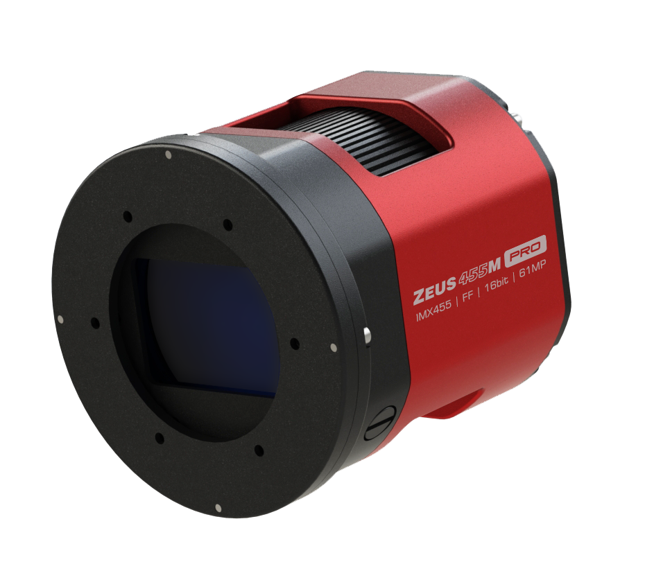

ZEUS 455M Pro cooled camera is developed by Player One Astronomy, it’s design for advanced DSO imaging. it adopts Sony Industrial grade IMX455ALK-K full-frame format monochrome sensor. The 3.76um pixel size accommodates a well depth of 71.6Ke with a total of 61MP  (the resolution is 9576*6388), and the diagonal is 44.3mm.

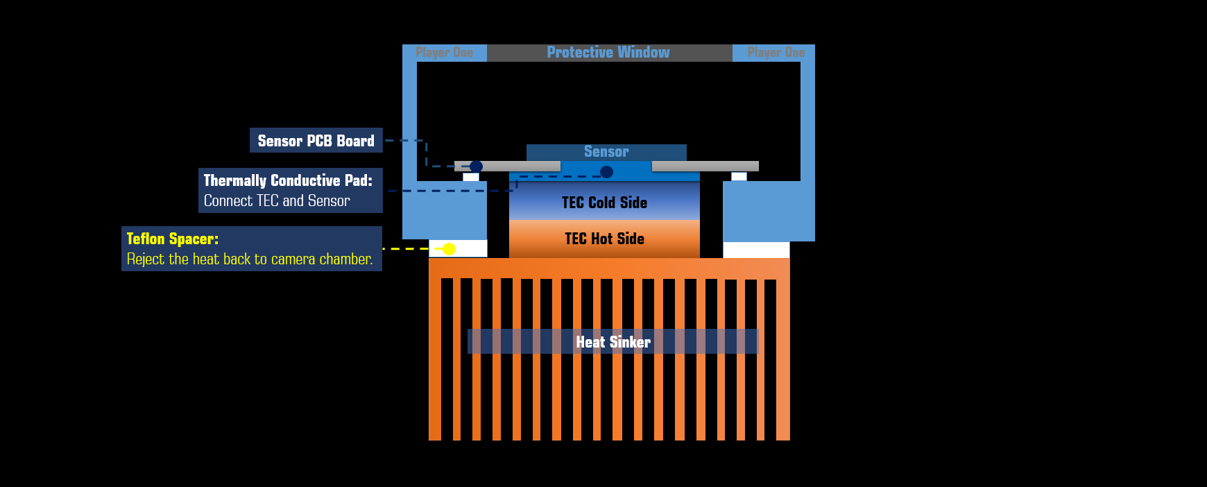

Deep Cooling
Player One cooled camera series use 2 Stage TEC Cooling unit, after improved the structure design to reject the heat back to camera chamber, Zeus Camera Delta-T can reach about 35℃.

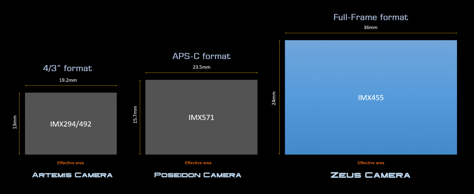

Full-Frame Format
ZEUS 455M Pro cooled camera has full-frame format (36mm*24mm), it is very suitable for professional DSO imaging.

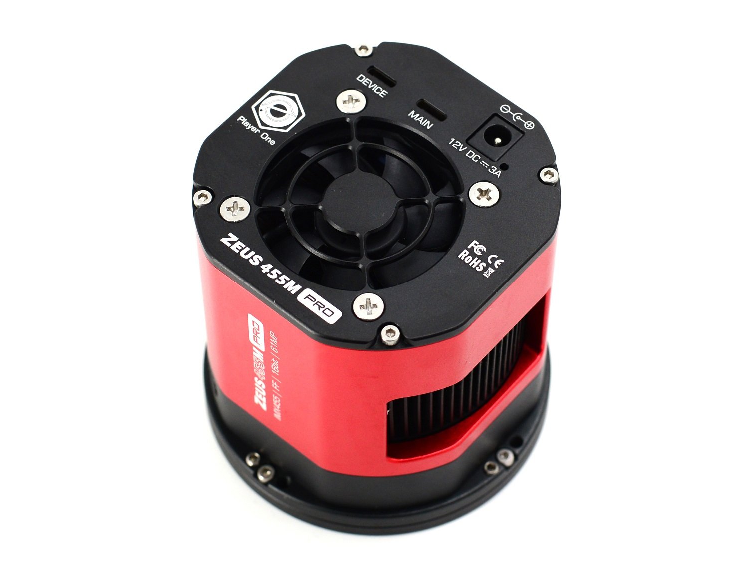

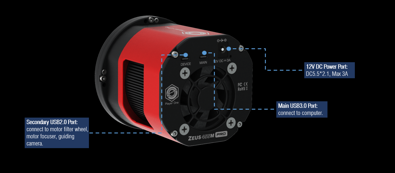

Type-C Data port and Power port
Back piece of cooled camera has 2 Type-C data port and 12V DC 5.5×2.1mm power port.
Main data port support USB3.0 protocol, the camera can run 6.5fps under RAW8 mode. Type-C port is easier to plug in when assemble the imaging equipment in night.
When recording images, since the actual writing speed will be affected by the writing speed of the hard disk itself, when the hard disk writing speed is slow, the recording may not reach the theoretical speed. It is recommended that you use a high-quality solid state drive to record data to give full play to the performance of the camera.
The camera has 12V DC5.5*2.1mm port to provide enough power to TEC cooling system. If you don’t need to power up cooling, only need to connect the main Type-C port, the camera will works as a uncooled camera.
