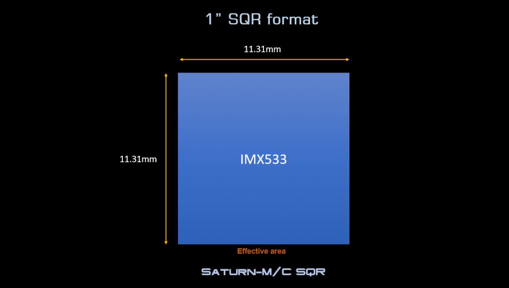

Saturn-C SQR camera has 1″ format, this size is quite big for imaging.

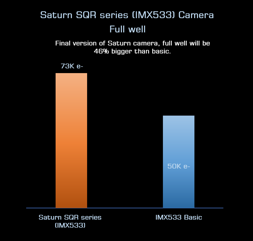

Extend Full well Capacity
Based on our technology, we improved the full well of Saturn-M SQR camera to 73Ke , it’s almost 1.5 times than IMX533 Basic (50ke).

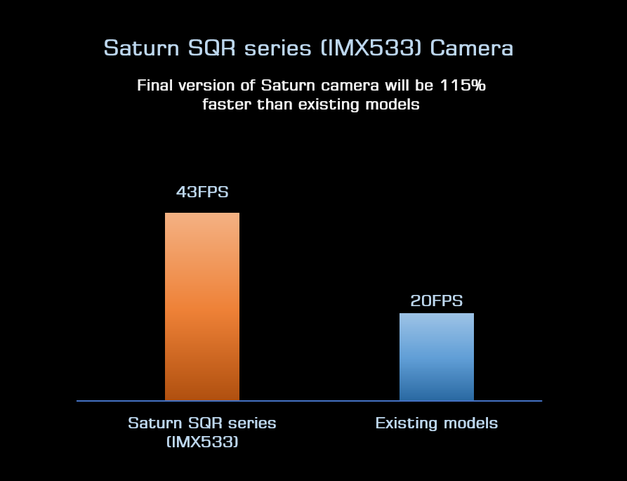

High Frame rate
Based on our technology Saturn-M SQR camera can run 43FPS under RAW8 mode, that’s much faster than existing models on market.

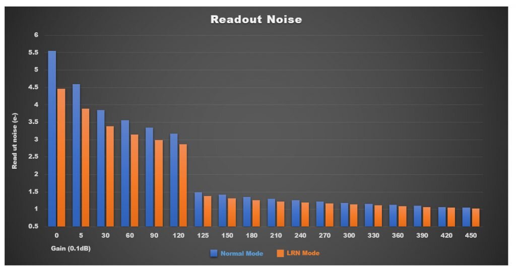

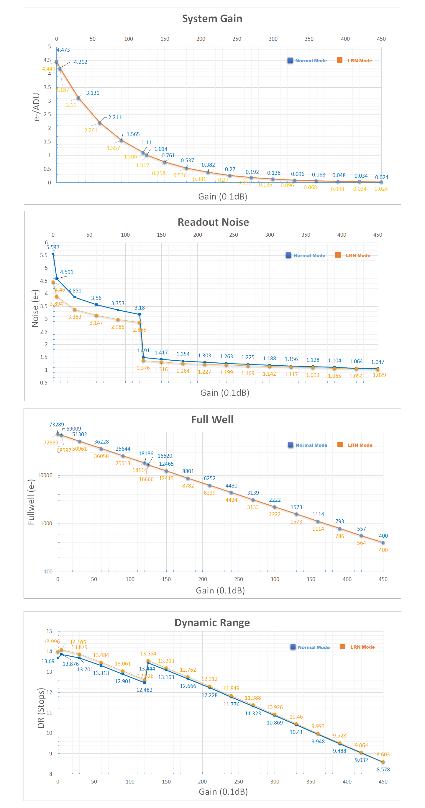

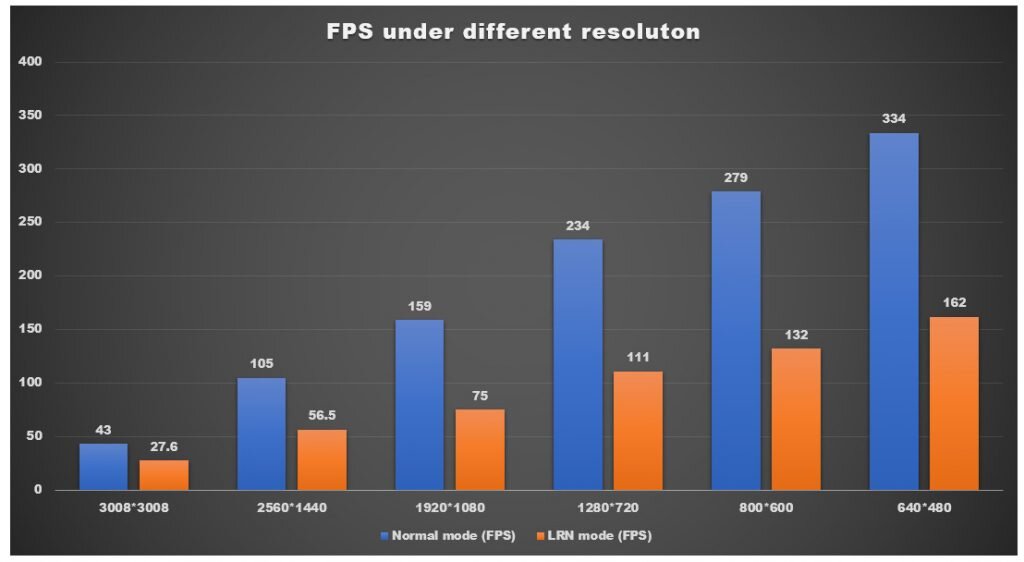

Dual Sampling Mode
Saturn SQR series has dual sampling mode. Nromal mode and LRN mode, they has different advantages in imaging.
1. Normal mode has faster FPS, it is more suitable for planetary imaging.
2. LRN (low readout noise) mode has lower readout noise and higher dynamic range. it is more suitable for DSO lucky imaging. SEE IMAGE

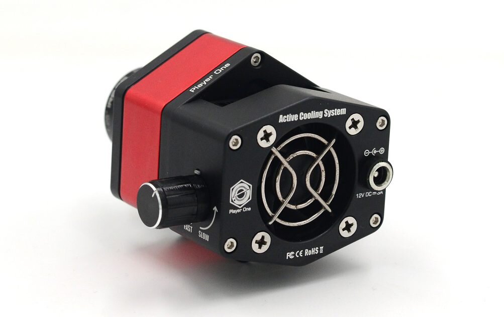

ACS (Active Cooling System) is a external air-cooled system, designed for solar and big format planetary cameras which already has PCS (Passive Cooling System).
ACS can provide much better temperature control. When camera has PCS + ACS, temperature is only 7℃ higher than ambient, camera body is a little warm but won’t hot!
ACS is not only can be used in daylight for solar imaging, it also could be used in night for DSO lucky imaging.

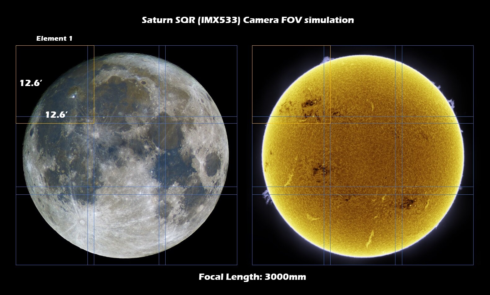

Saturn SQR camera also very good for lunar and planetary imaging, its 1″ big format and 9MP total pixels, easier to capture full disk of the Moon and the Sun, or make mosaic more efficient.

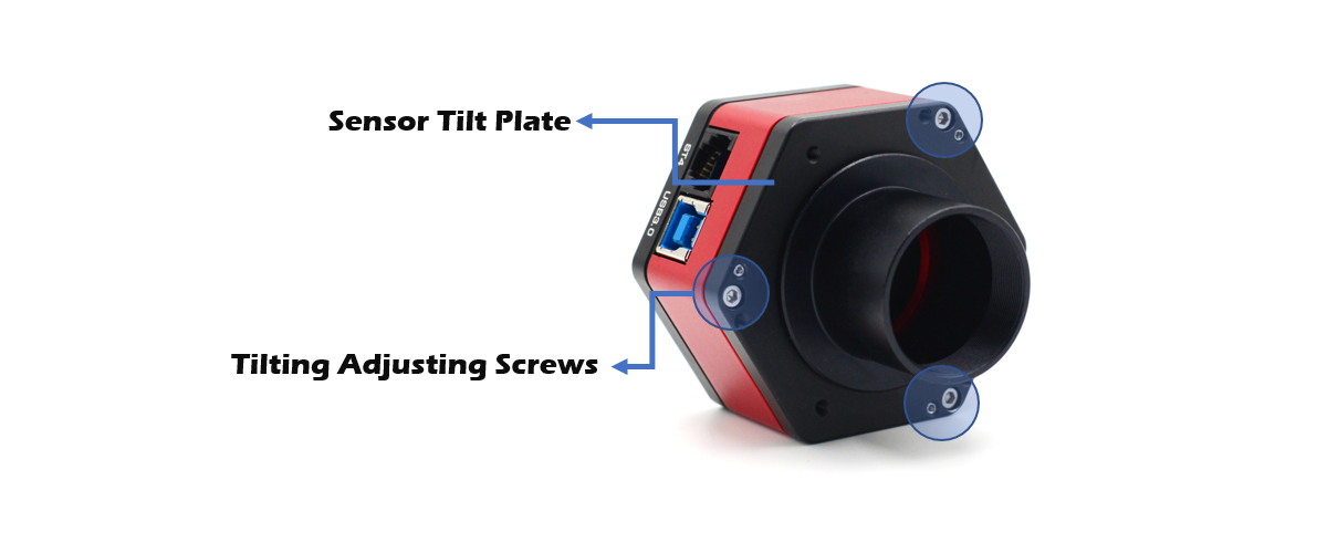

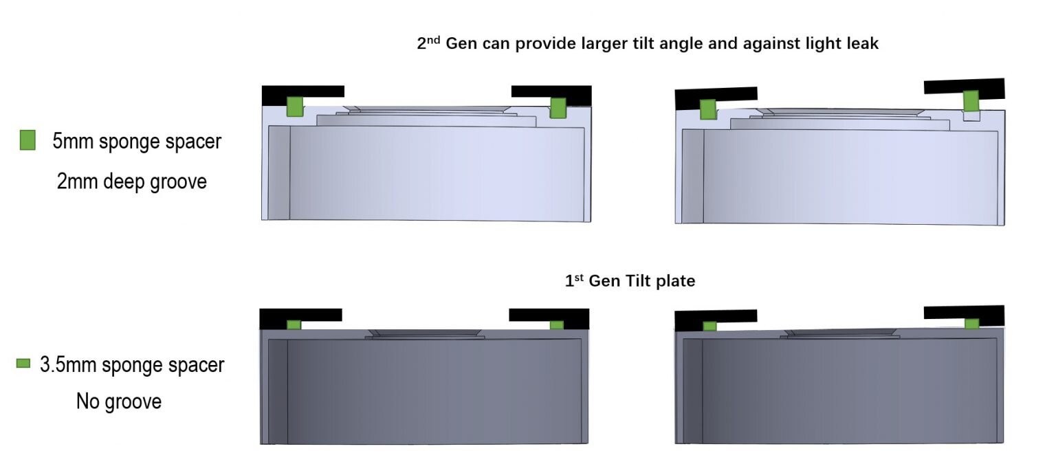

2nd Gen – Sensor Tilt Plate
When taking deepsky objects, using sensor tilt plate can get a much smaller field curvature of the telescope.
The built-in high-density sponge shading pad can block the light from the side slits without any side leakage.

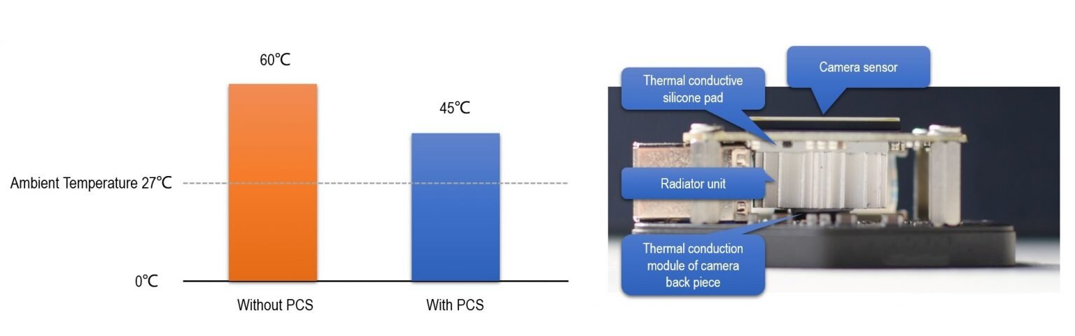

Player One add a new feature called Passive Cooling System to conduct the heat from the sensor out.

HCG open at gain=125. Saturn SQR series has dual sampling mode, Normal mode has faster fps, LRN (low readout noise) mode has lower readout noise and higher dynamic range.

Format

Dual Sampling Mode

Chip Size
11.31mm×11.31mm

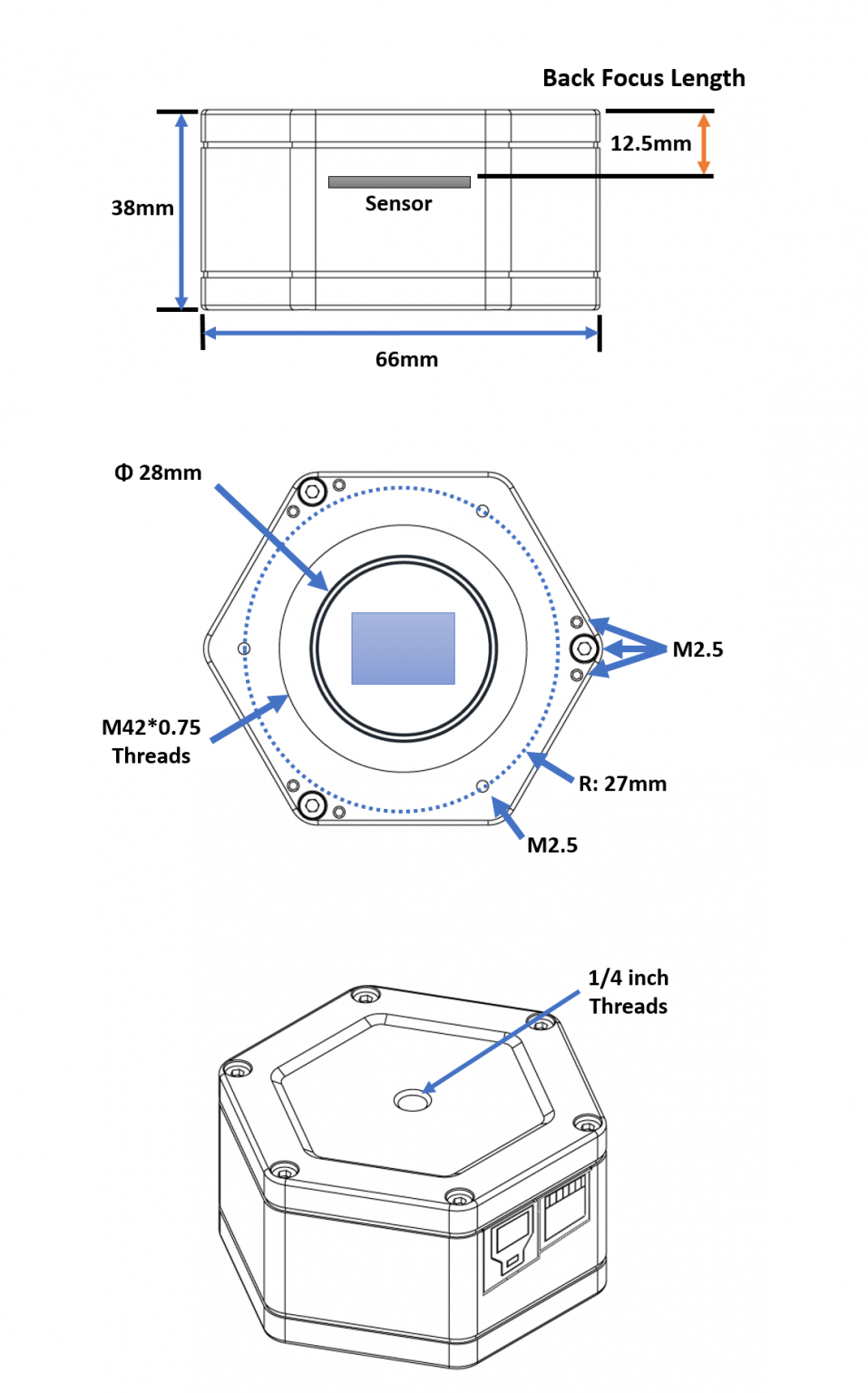

Back Focal Length
12.5mm

Diameter
66mm

Resolution and FPS
Under USB3.0 mode
Resolution 10bit ADC 14bit ADC
3008×3008 43FPS 21.5FPS
2560×1440 105FPS 52FPS
1920×1080 159FPS 73FPS
1280×720 234FPS 108FPS
800×600 279FPS 129FPS
640×480 334FPS 159FPS
