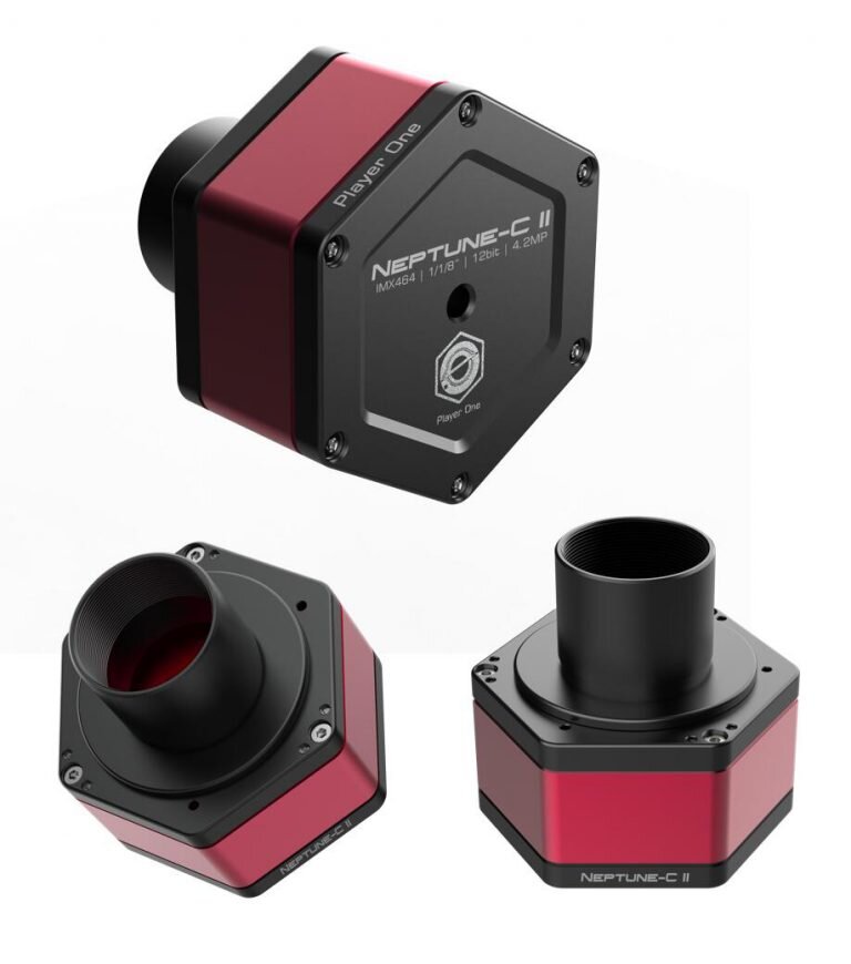

Neptune-C II is a planetary camera developed by Player One Astronomy, which adopts the Sony IMX464 1/1.8” format sensor. The 2.9um pixel size accommodates a well depth of 12ke with a total of 4.2MP  (the resolution is 2712*1538), and the diagonal is 9mm.
Everyone should know that the rookie IMX462 chip currently on the market has become the new favorite of planetary shooting, and IMX464, as a product of the same process, is equivalent to an enhanced version of IMX462, with a larger target surface and higher resolution. Come for a better shooting experience.

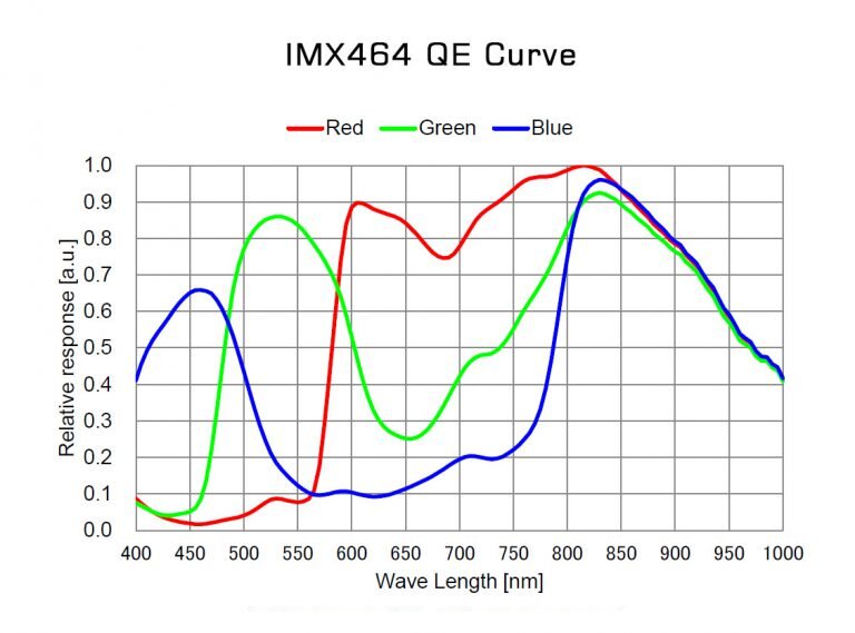

Near infrared super light sensitivity
Not only that, IMX464 also has ultra-sensitive infrared sensitivity characteristics, suitable for playing infrared photography, whether it is matched with IR685, IR850 or CH4 filters, it will give you a new visual experience.

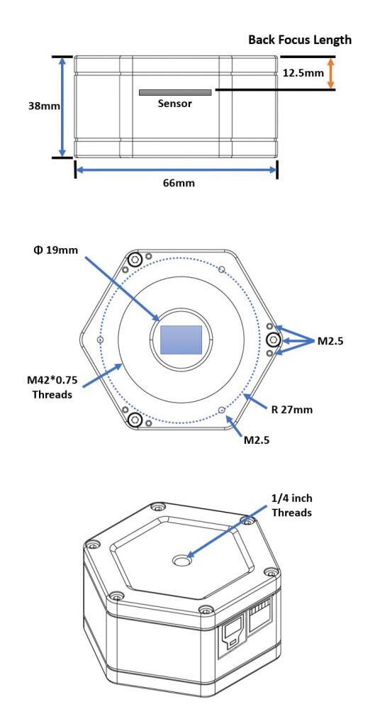

1.25″ / M42X0.75
Back Focal Length
12.5mm
Protective Window
D21*1.1MM High Quality AR Plus (Anti Reflection) Multi-Layer Coating
Diameter
66mm
180g
