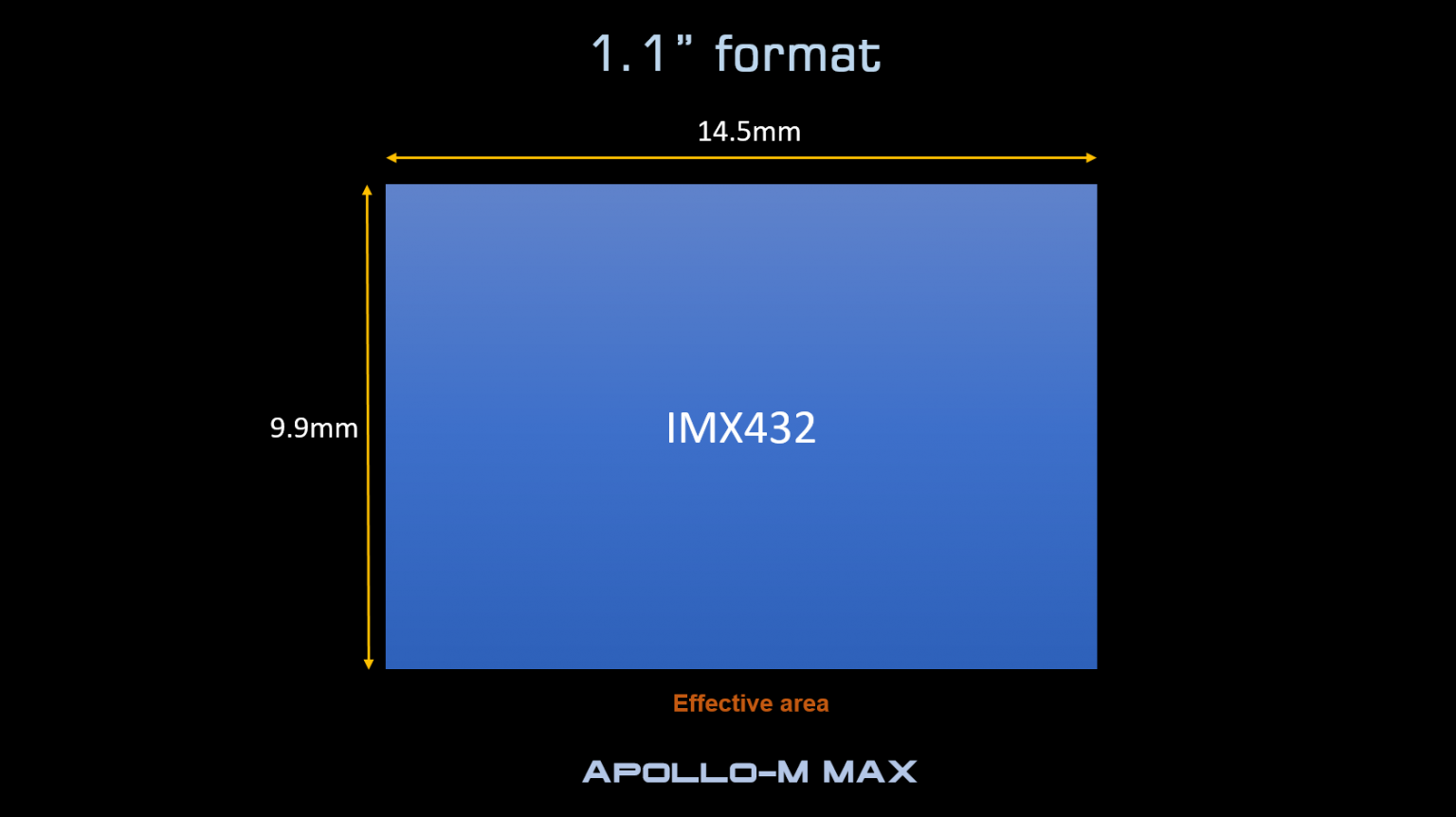

IMX432 has 1.1″ format, it is pretty big, almost twice of IMX174 chip.

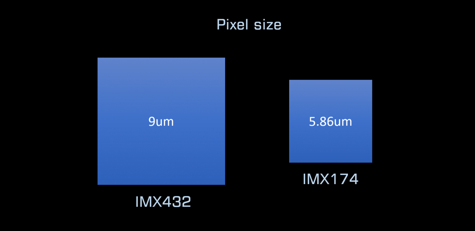

Pixel size
9um pixel size is 1.5 times bigger than IMX174 camera, which means it can works at longer focal ratio, such as SCT + Daystar filter(with 4.2X) .

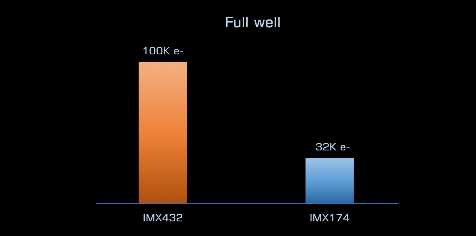

100Ke full well, is 3 times bigger than IMX174. This feature will bring some new possibility in imaging. What we can imagine is HDR the Sun and prominence, or maybe the bright and dark side of the Moon.

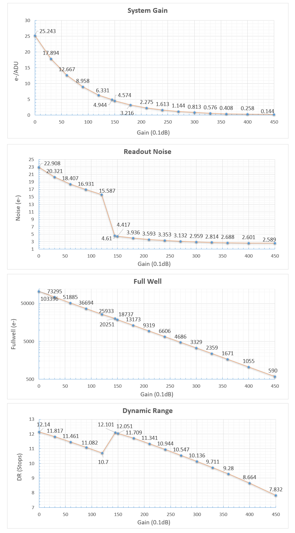

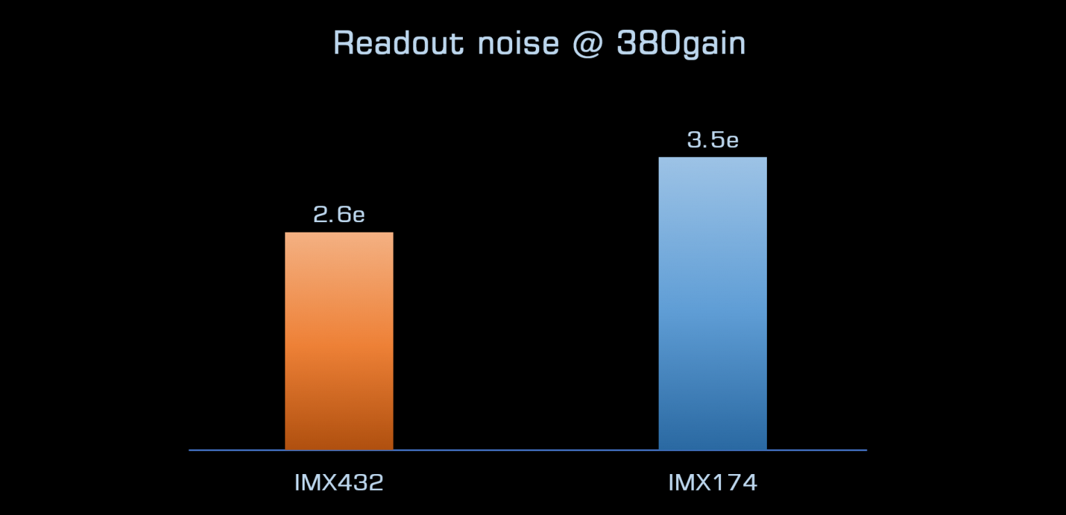

HCG and Noise
HCG mode will automatic open when Gain >145, readout noise will drop to 4.6e. And dynamic range will rise to 12 drops again.
At 380 gain, readout noise of IMX432 is 2.6e, it is lower than IMX174. And full well will still bigger than IMX174.

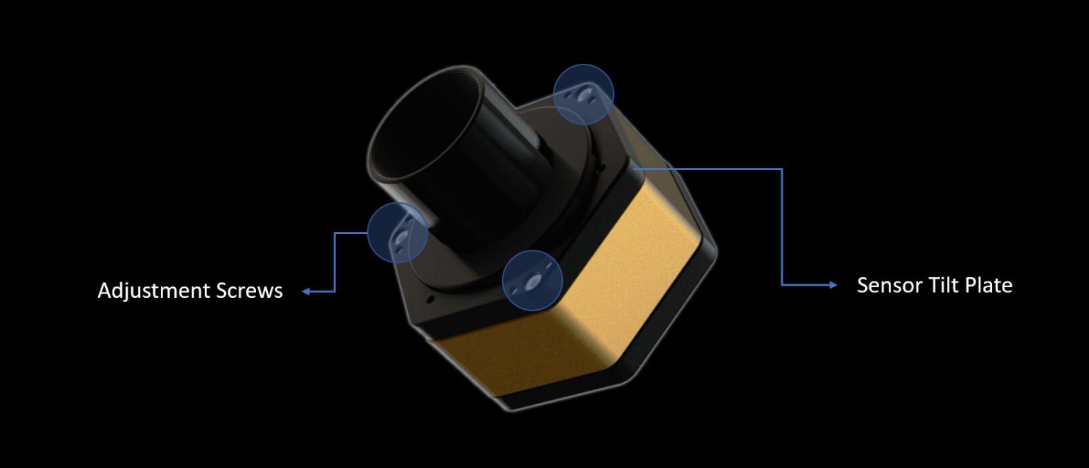

Sensor Tilt Plate
When taking solar photograph with prominence telescope, the Newton ring is annoying. Smoother solar image without Newton ring could be taken by adjusting the focal plate. Get a much smaller field curvature of the telescope.
The built-in high-density sponge shading pad can block the light from the side slits without any side leakage.

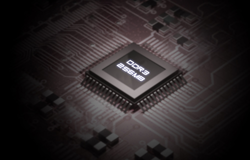

 256M DDR3 Cache
Player One Astronomy cameras are the first one who adpots the DDR3 cache in all planetary cameras in the world! It helps stabilize and secure data transmission, it effectively avoids frame dropping and greatly reduces readnoise.
With the DDR3 cache, the camera does not have high demands on computing needs any longer, it will still has excellent performance even if it is connected to a USB 2.0 port.

The Apollo-M MAX camera has a unique HCG mode, which will automatically turn on when the camera gain setting is >145. The HCG mode can greatly reduce the readout noise and retain the same high dynamic range as the low gain.

Chip Size
14.5mm×9.9mm

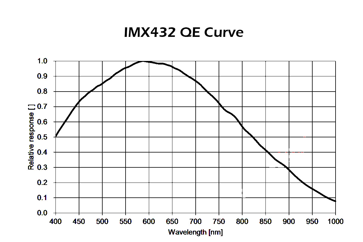

QE Peak
≈77%

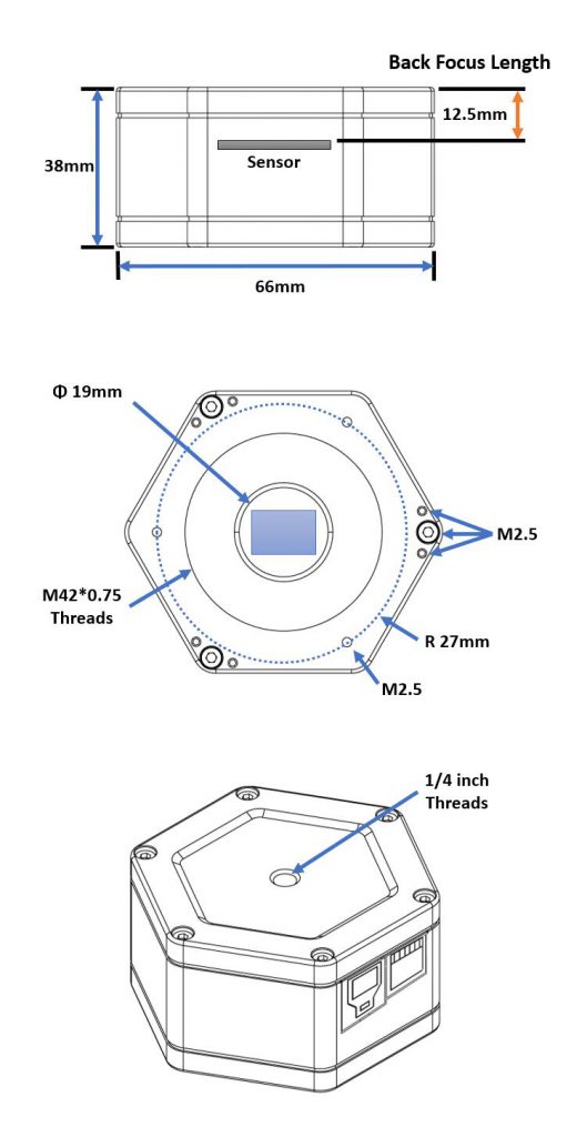

Back Focal Length
12.5mm

Diameter
66mm
