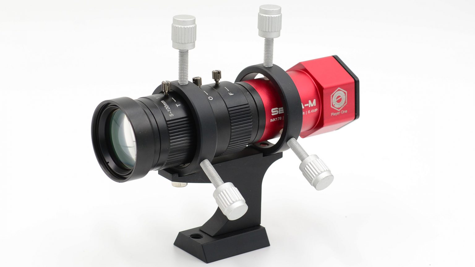

With a 5-100MM CS lens attached on the camera, it also can be used as a guider or finder.

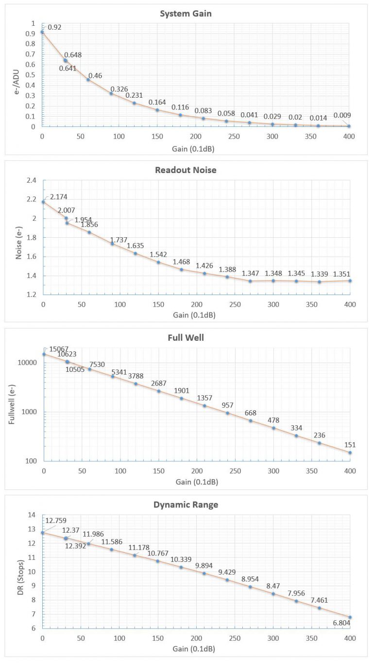

After many rigorous readout noise tests, the Sedna-M camera can reach a low readout noise of 1.34e at a gain of 350.
HCG  Mode
The Sedna-M camera has a unique HCG mode, which will automatically turn on when the camera gain setting is >30. The HCG mode can greatly reduce the readout noise and retain the same high dynamic range as the low gain.

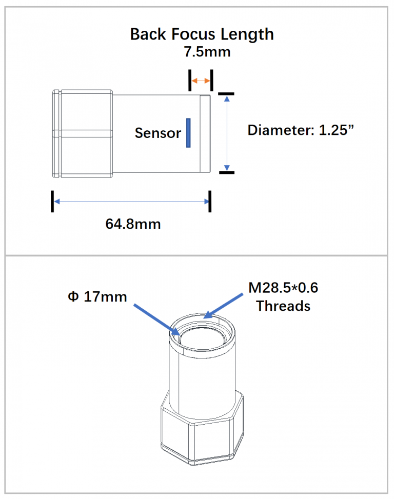

Sensor
SONY IMX178 1/1.8" CMOS (mono)
Diagonal
9mm
Total Pixels
6.4 Mega Pixels
Max Resolution
3096×2078
Pixel Size
2.4μm
Chip Size
7.4mm×5.0mm
Frame Rate
60FPS(10bit)
Shutter
Rolling shutter
Exposure Range
32μs-2000s
2.2e~1.3e

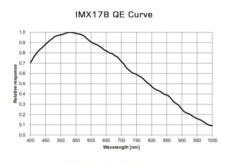

QE Peak
≈80%
15k e
ADC
14 bit

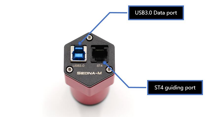

USB3.0/USB2.0
Adapter
1.25″ / M28.5X0.6
Back Focal Length
7.5mm
Protective Window
AR coating
Diameter
40mm
65g
Resolution and FPS
Under USB3.0 mode
Resolution 10bit ADC
3096×2078 60 FPS
