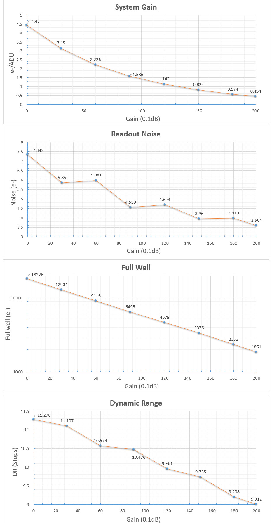

After many rigorous readout noise tests, the Ceres-M camera can reach a low readout noise of 3.6e at a gain of 200.

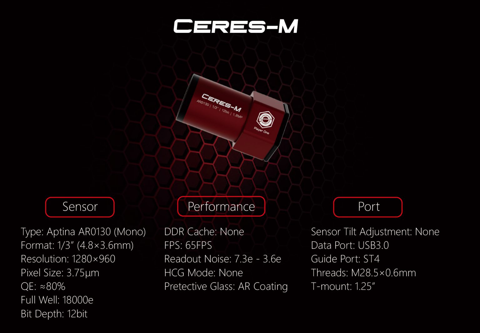

Sensor
Aptina AR0130 CMOS (Mono)
Diagonal
6mm
Total Pixels
1.2 Mega Pixels
Max Resolution
1280×960
Pixel Size
3.75μm
Chip Size
4.8×3.6mm
Frame Rate
65FPS(10bit)
Shutter
Rolling shutter
Exposure Range
32μs-2000s
7.3e – 3.6e
QE Peak

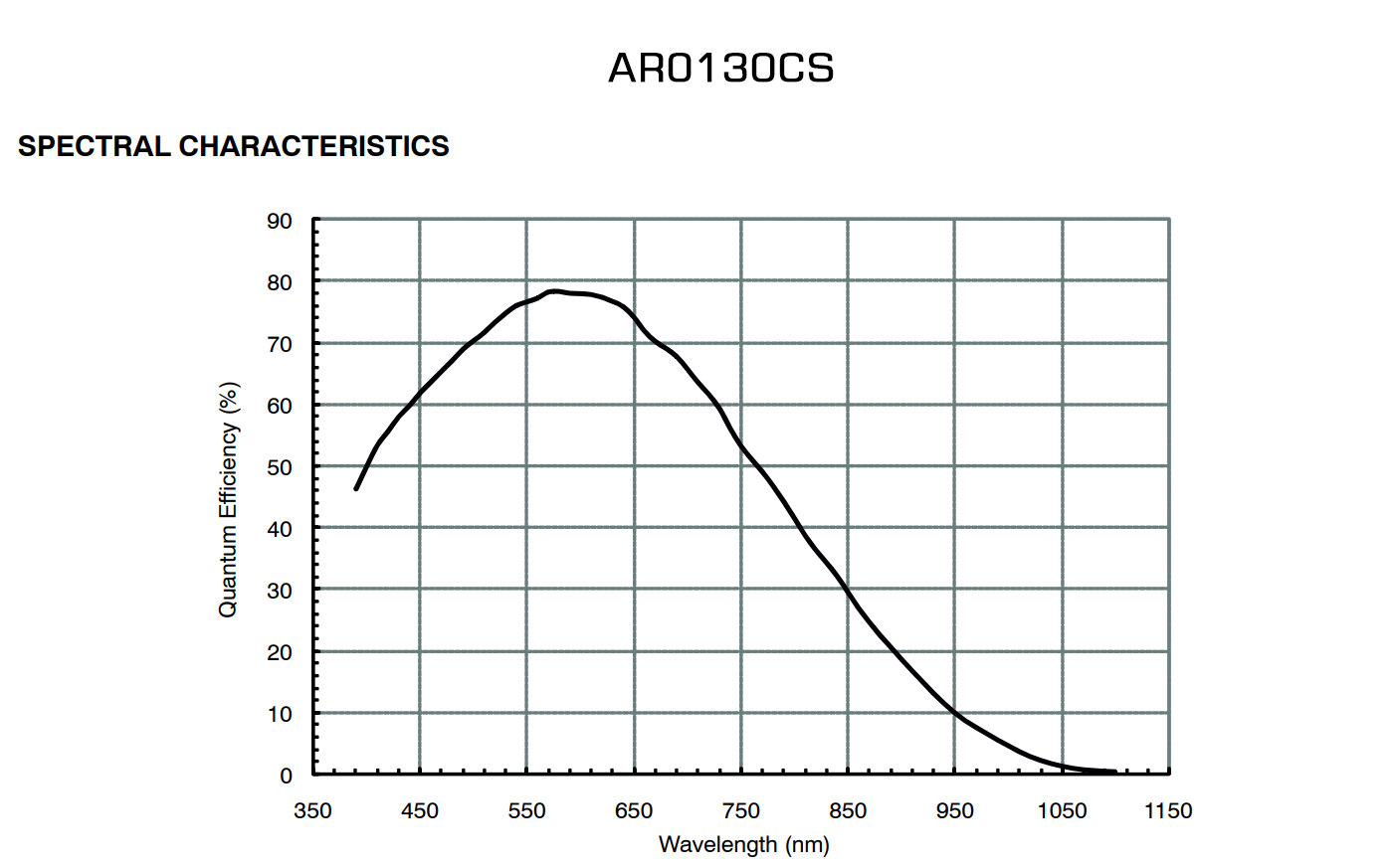

≈80%
18k e
ADC
12 bit
USB3.0/USB2.0
Adapter

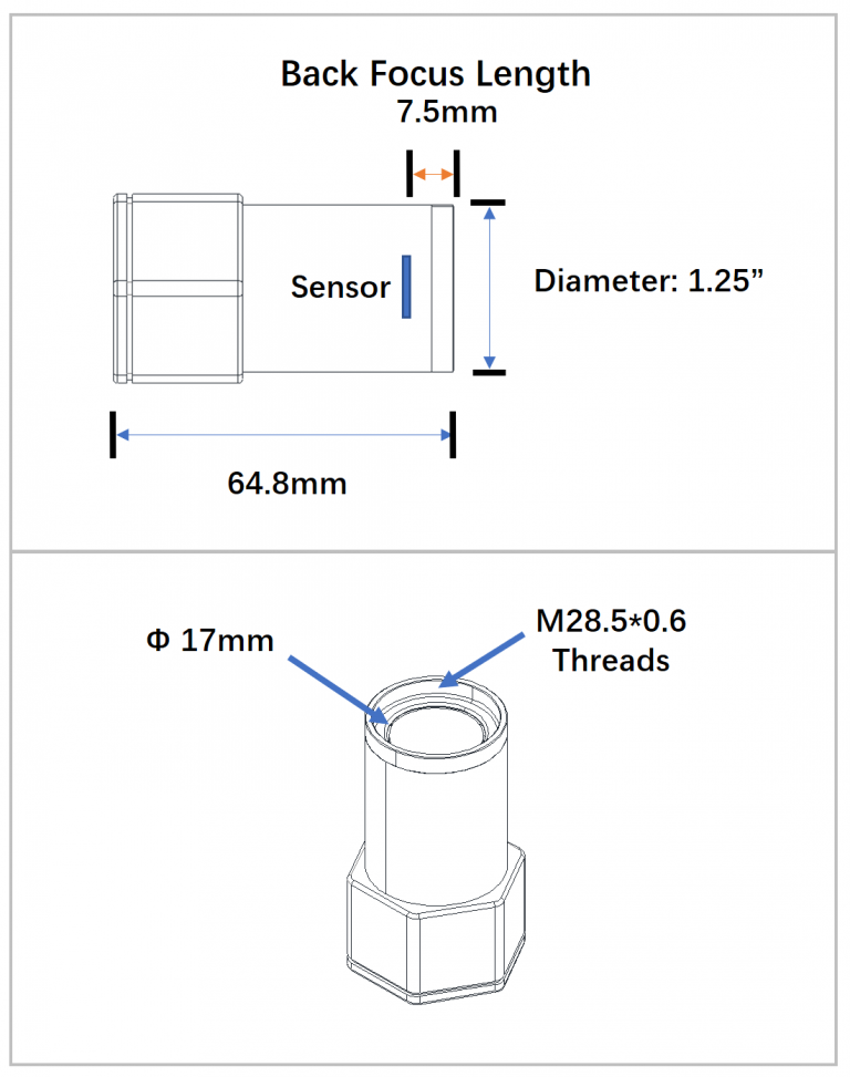

1.25″ / M28.5X0.6
Back Focal Length
7.5mm
Protective Window
AR coating
Diameter
40mm
65g
Resolution and FPS
Under USB3.0 mode
Resolution 10bit ADC
1280×960 65 FPS
