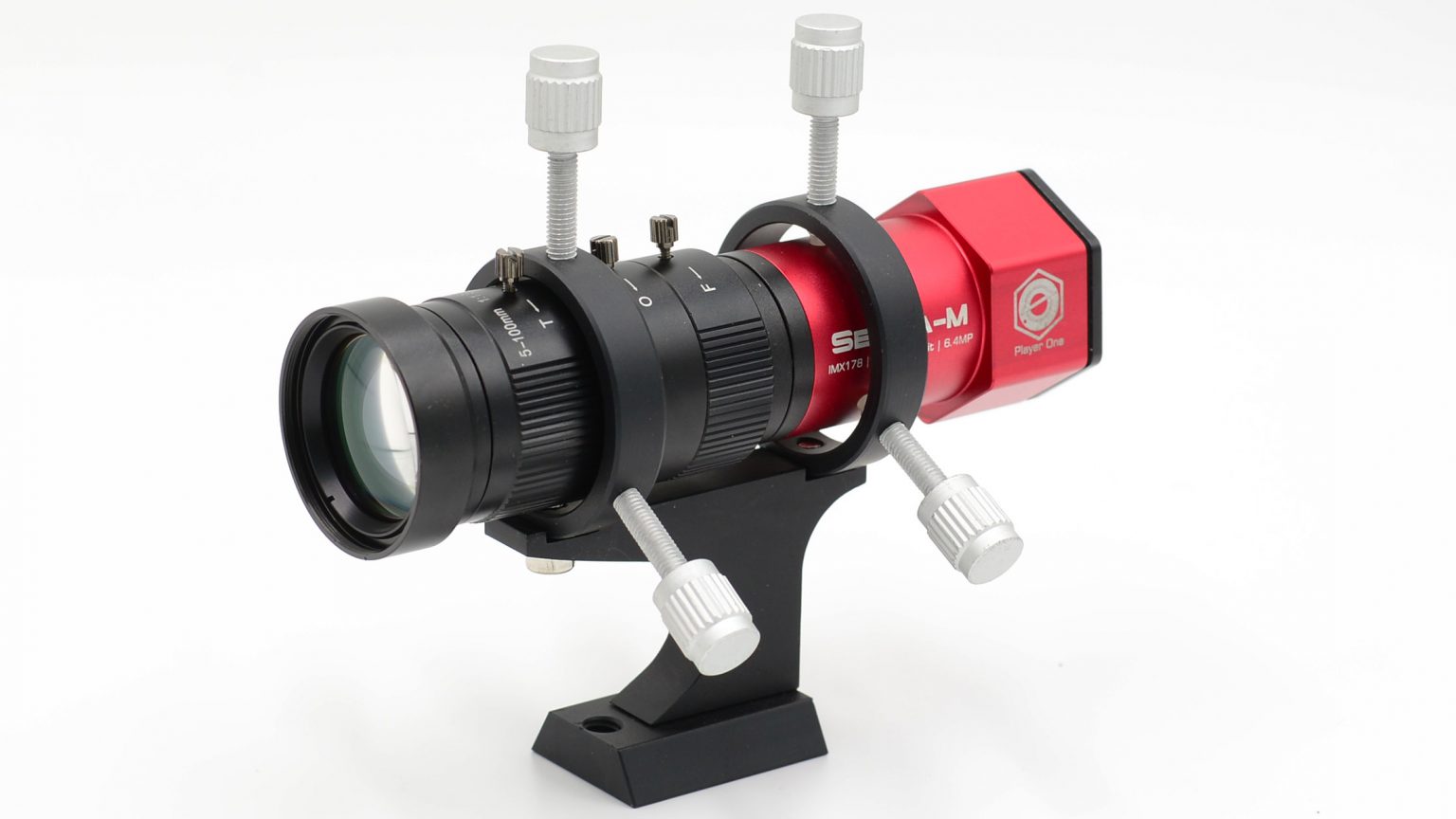

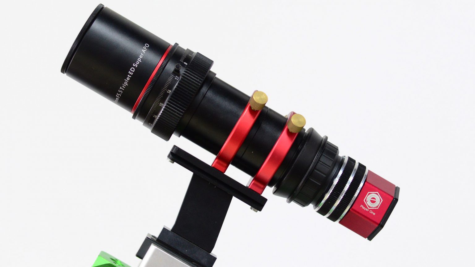

Dwarf planet series integrated USB3.0 data port(500Mb/s), which can provide over 10 times speed than USB2.0 device(60Mb/s). Whatever you wants to do guiding or imaging, this camera series can handle it very well.Dwarf planet camera diameter is 1.25″, it can slide in 1.25″ holder of guiding scope, makes the whole setup shorter.With a 5-100MM CS lens attached on the camera, it also can be used as a guider or finder.

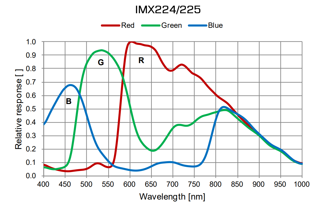

When the camera is connected to the USB3.0 interface and full-resolution preview is used, it can reach 154 FPS in RAW8 mode (10bit ADC). When recording images, since the actual writing speed will be affected by the writing speed of the hard disk itself, when the hard disk writing speed is slow, the recording may not reach the theoretical speed. It is recommended that you use a high-quality solid state drive to record data to give full play to the performance of the camera.
After many rigorous readout noise tests, the Ceres-C camera can reach a low readout noise of 0.75e at a gain of 350.

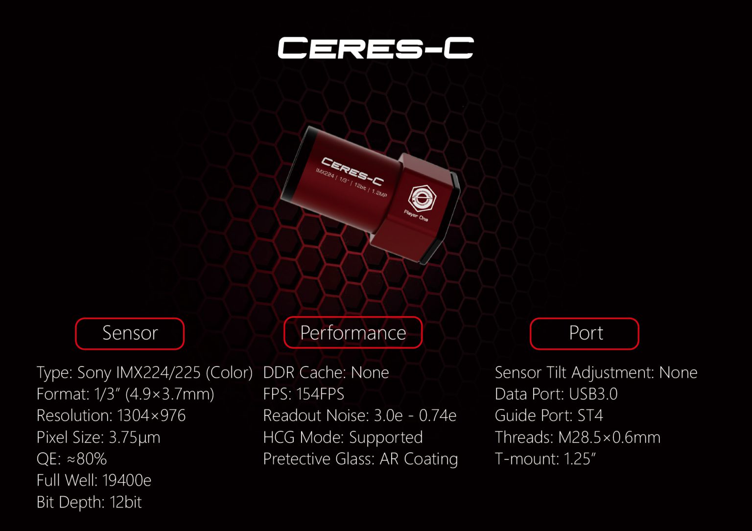

Sensor
Sony IMX224/225 CMOS (Color)
Diagonal
6mm
Total Pixels
1.2 Mega Pixels
Max Resolution
1304×976
Pixel Size
3.75μm
Chip Size
4.9×3.7mm
Frame Rate
154FPS(10bit)
Shutter
Rolling shutter
Exposure Range
32μs-2000s
3.0e – 0.74e
QE Peak
TBD
19.4k e
ADC
12 bit
USB3.0/USB2.0
Adapter

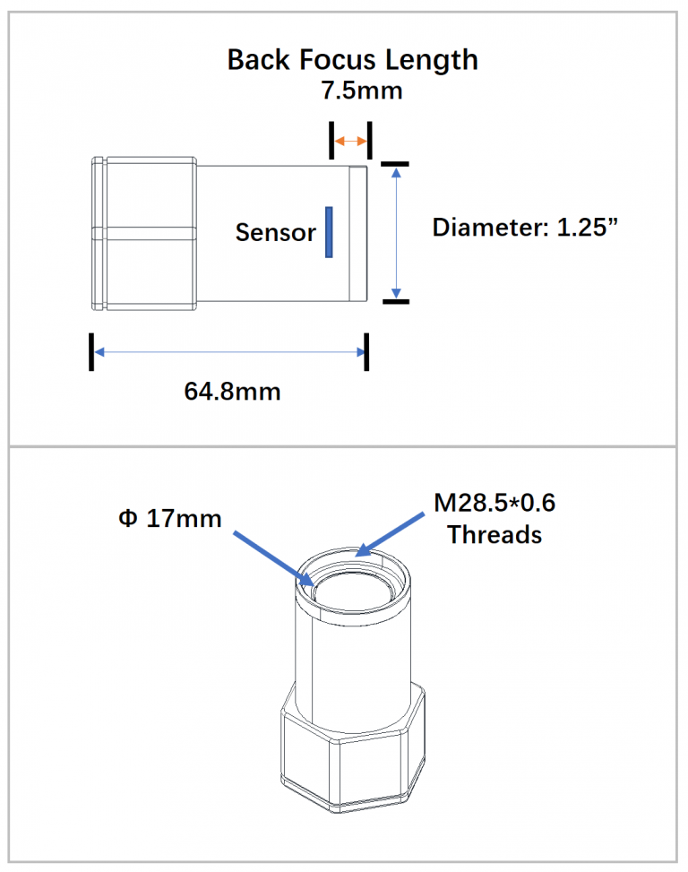

1.25″ / M28.5X0.6
Back Focal Length
7.5mm
Protective Window
AR coating
Diameter
40mm
65g
Resolution and FPS
Under USB3.0 mode
Resolution 10bit ADC
1304×976 154 FPS
