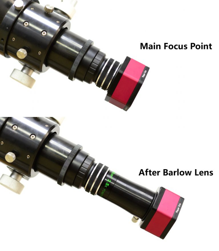

Connecting the Mars-M camera to a telescope with an 1.25″ T-Mount, or adding a Barlow lens between the camera and a telescope to extend the focal length for more details.

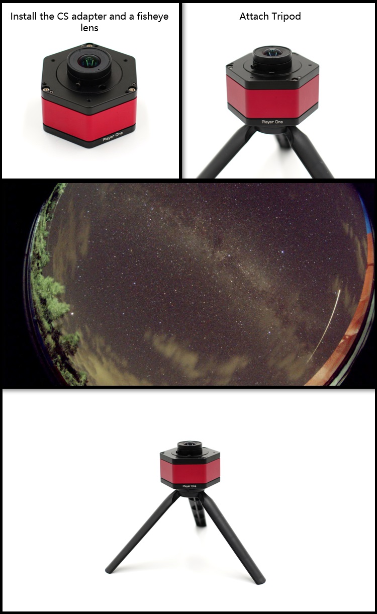

With a CS lens attached on the Mars-M camera,it can be used as an all-day camera or meteor monitoring camera, monochrome camera has better performance than color camera!

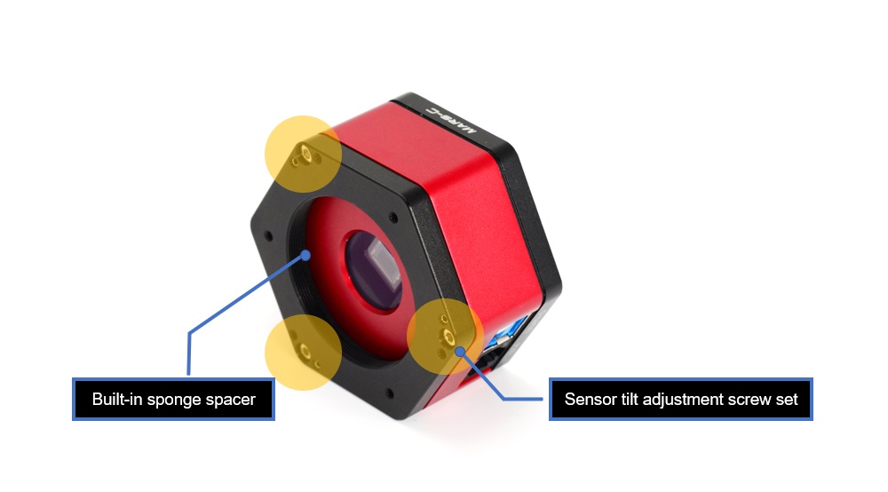

Sensor Tilt Plate
When taking solar photograph with prominence telescope, the Newton ring is annoying. Smoother solar image without Newton ring could be taken by adjusting the focal plate. Besides, when you use a planetary camera for deep-sky lucky imaging, if you find the surrounding stars are not perfect, you can adjust the sensor tilt plate to obtain a flatter image field. get a much smaller field curvature of the telescope.
The built-in high-density sponge shading pad can block the light from the side slits without any side leakage.

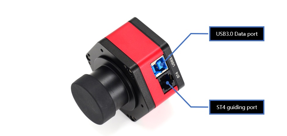

 USB3.0 Port and ST4 Port
When the camera is connected to the USB3.0 interface and full-resolution preview is used, it can reach 136 FPS in RAW8 mode (10bit ADC), and the frame rate in RAW16 mode (12bit ADC) is 64 frames per second. When recording images, since the actual writing speed will be affected by the writing speed of the hard disk itself, when the hard disk writing speed is slow, the recording may not reach the theoretical speed. It is recommended that you use a high-quality solid state drive to record data to give full play to the performance of the camera.

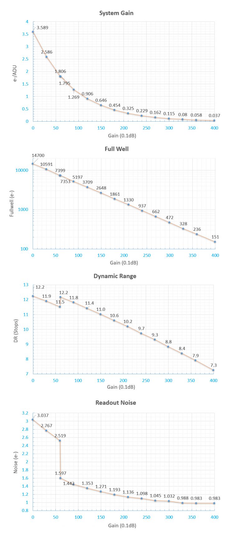

After many rigorous readout noise tests, the Mars-C camera can reach a low readout noise of 0.73e at a gain of 350 and around 0.7e at a gain of 400.
HCG Mode
The Mars-M camera has a unique HCG mode, which will automatically turn on when the camera gain setting is ≥60. The HCG mode can greatly reduce the readout noise and retain the same high dynamic range as the low gain.

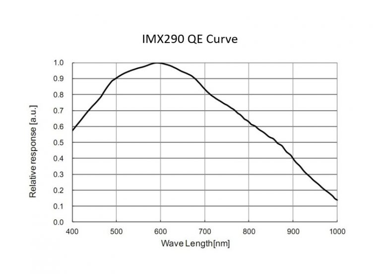

QE Curve
The peak value of QE of Mars-M camera is about 80%, and it has very strong ultraviolet and infrared sensitivity. The actual QE value can be estimated by multiplying the ordinate of the official relative QE graph (below) by 80%.
HCG Mode
QE Curve

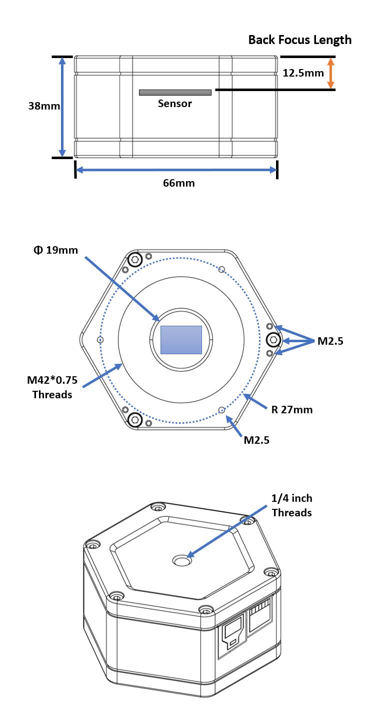

Back Focal Length
12.5mm
Protective Window
AR coating
Diameter
66mm
180g
