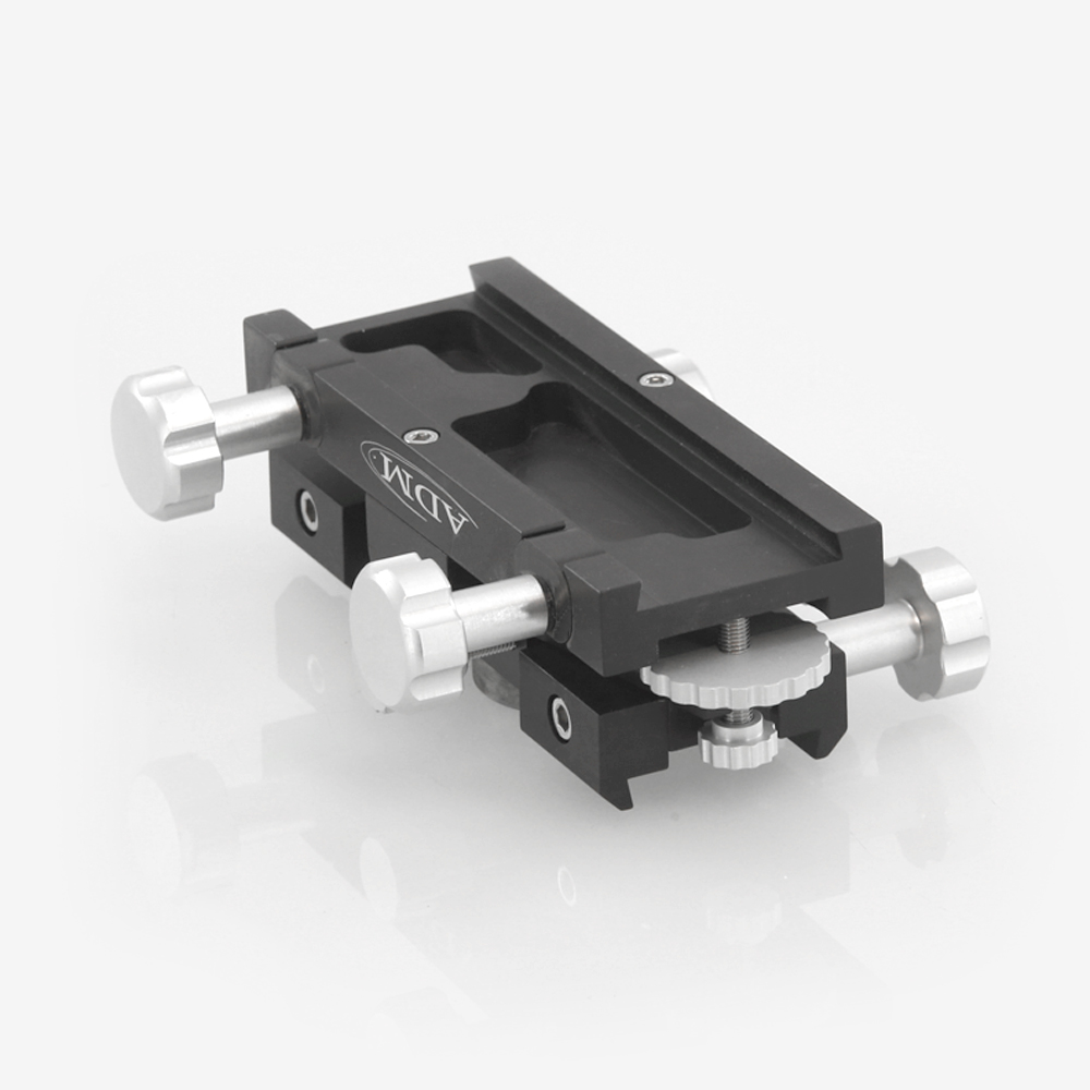

ADM Accessories: -Alternative to adjustable guidescope rings.
-Supports guidescope/finderscope with tube rings and dovetail bar for added stability and simple adjustability.
-Used for co-aligning two optical tubes for viewing the same target or offsetting two optical tubes to find a suitable guidestar for autoguiding.
-Designed entirely for the Vixen “V” series of dovetail bars to help reduce the overall weight to under 2 lbs.
-Capable of handling any guidescope under 10lbs.

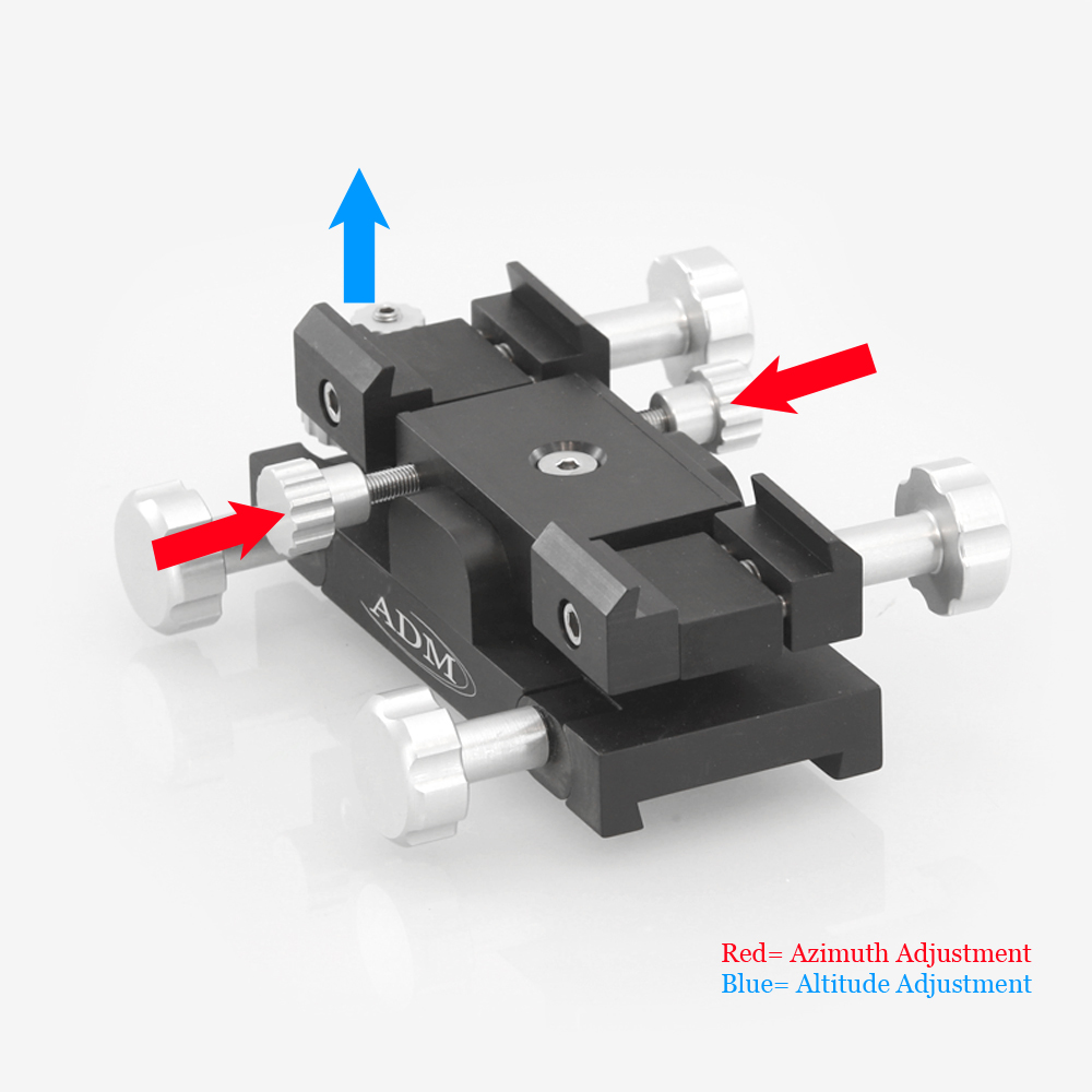

-10 degrees of Azimuth adjustment and 5 degrees of altitude adjustment.
-6.4″ long and adds approximately 1.6″ of height (from top of dovetail on OTA to bottom dovetail on guidescope).
-CNC machined from aircraft quality 6061 aluminum.
-All components are anodized aluminum and stainless steel for a beautiful finish and long lasting durability.
-1x MINI-MAX Guider ALT/AZ Aiming Device
