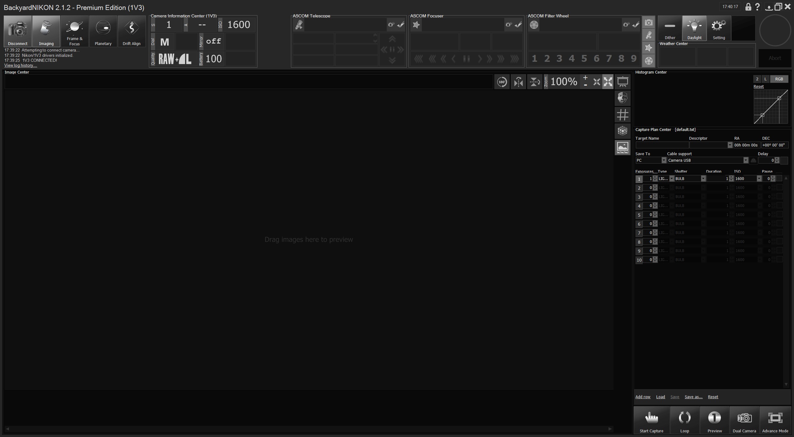

So I just bought BYN because it states it can work with the Nikon 1 V3. However when I connect to it, although it recognizes the camera, and the FRAME AND FOCUS control works, the CAMERA INFORMATION CENTER is listing incorrect information. I have the camera set to manual, the shutter to bulb, and the ISO to the base 160. As you can see in the first screen grab below, that's not what BYN lists.

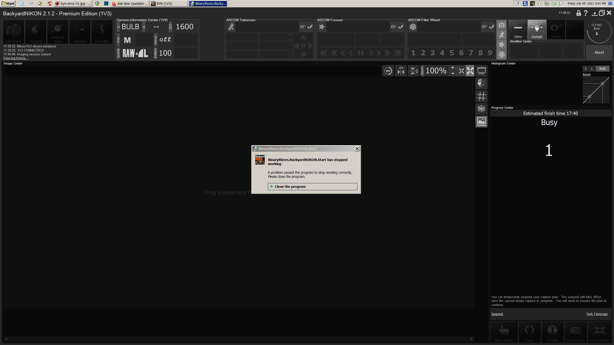

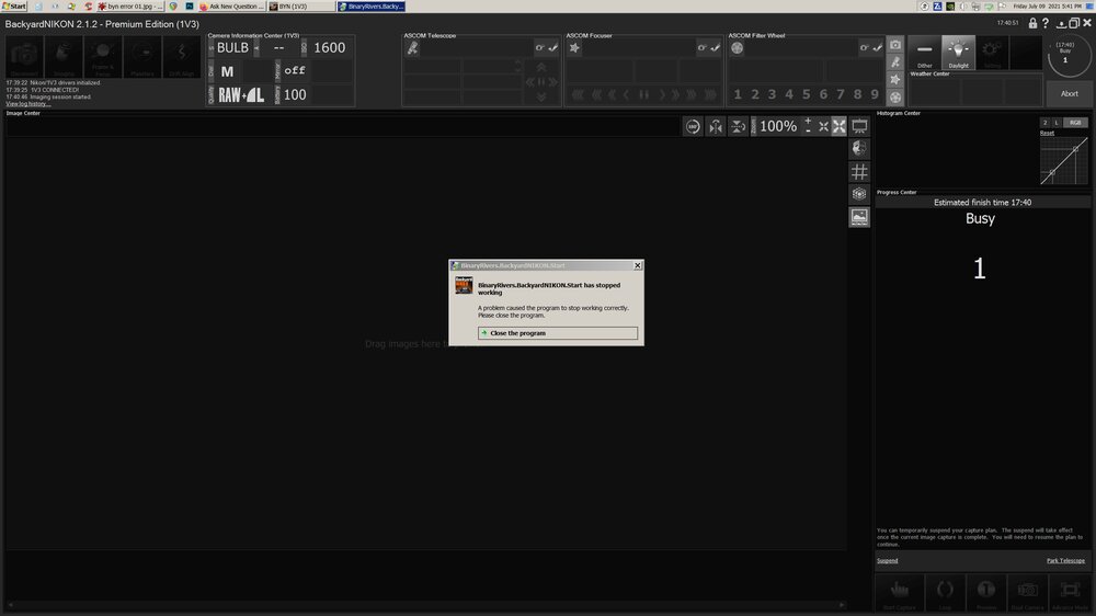

When I try to shoot the generic sequence that the program starts with by hitting the START CAPTURE button, BYN crashes, as you can see in the second screen grab. Also note the estimated finish time for a one second exposure. Occasionally it doesn't crash, but it just hangs there, the wheel on the upper right just goes round and round and it lists some crazy estimated finish time for a 1 second exposure.

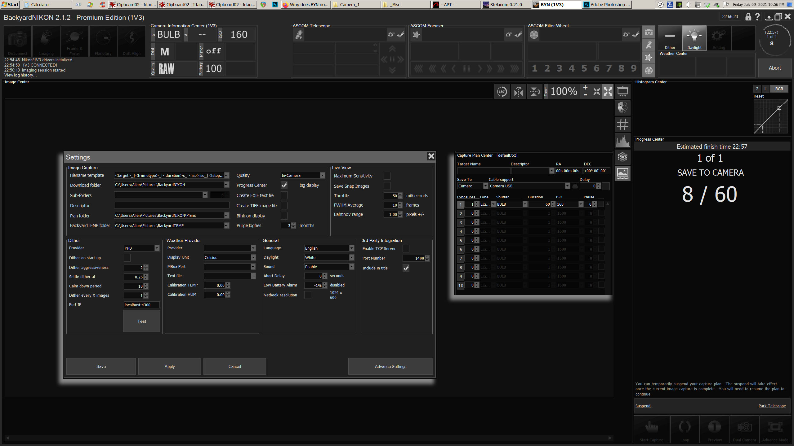

So you said Frame & Focus works. Can you see the LiveView frames in the main part of the BYN window? Have you tried temporarily disabling your anti-virus software? It could be preventing BYN
astroman133
Comments on your previous test with In-Camera Quality and Save To Camera. 1- You said that the capture executes and but that no image is saved to the camera's memory card. How did you verify that
