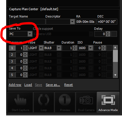

  1. Do you get an error message in BackyardNIKON?
  2. Please make sure you save to "PC" only
Yes, it's true, what Google Translate can do!
1. No, no mistakes whatsoever. When I take the photograph, for example at 1/200 second per test, the machine clicks (I can hear the noise) then once it has taken, it says "busy" and starts to turn the icon at the top right , the problem is that it never ends! I am forced to close the program forcibly ... :(
I have also compared it to videos of the software on Youtube and it absolutely does not do this job.
2. The selector is already set on "Pc only"

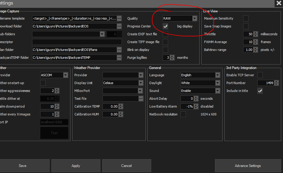

Francesco,
I hope that the log file reveals clues to your issue.
Please understand that there are other users of BYN, even some with the D810 who do not experience the same issue as you are seeing. This leaves the admins and people like myself who try to help people a bit in the dark as to the cause of the issue.
Please make sure that the Download and BackyardTEMP folders exist and are writeable by BYN. The BackyardTEMP folder must be on a local, always available, drive. It will not work to put BackyardTEMP on a thumb drive.
Do you see any image files in the BackyardTEMP folder?

1 hour ago, astroman133 said:
Francesco,
Thanks for your patience.
Look up, there is the Log file :D
Can you please remind me what your issue is?  Initially is was that images are not saved to PC.  Is this still the issue you are trying to solve?
If yes, the logfile you provided is not good because you never tried to take any picture.
The problem is that I take the photo, the photo is taken because I hear the camera making noise, but when it goes to process everything the program freezes, and on the top right wheel it says "Busy" and turns endlessly . I can't even click on "Cancel" (the button under "Busy") because the program is not responding. The only way to exit the program is to close via the "X" at the top right, and when I do this I get a window that says "The BlackYardNikon program is taking pictures, are you sure you want to exit?" (or something like that) "YES" or "NO"? "
This is what he tells me .... I don't know what to do, tomorrow night I would need the program ..
2 hours ago, admin said:
At this point I think my recommendation is to try a factory reset on your camera.  I have a friend who has a D810a and he confirmed that everything works with his D810a.
