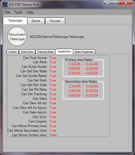

I decided to test the ASCOM Telescope user interface through BYE Rel 3.1.18 RC11. The DEC slew buttons do not work. The RA buttons work as expected. Everything works through the standard Telescope.NET interface and the Gemini-2 HC.

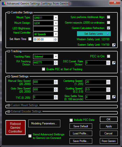

The speed setting in BYE is based on the Axis rate astroman speaks of, so this might be a good exercise to try his tool, but I respect your decision not to install it. If my memory serves me right BY
astroman133
I believe that it is common for the Telescope.AxisRates method to return the rates from slowest to fastest for the requested axis, but you should expect that the rate objects could be in any order. Do
