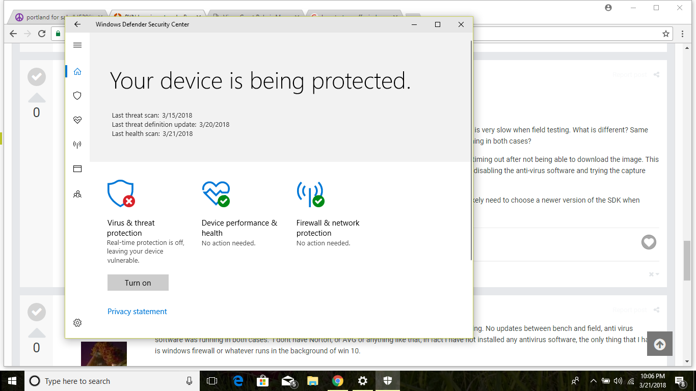

First, let's talk about the camera with inconsistent performance. It works fine when bench testing, but is very slow when field testing. What is different? Same PC, same camera, same cabling? Any PC updates between testing sessions? Anti-virus software running in both cases?
Looking at one of the log files I can see where you are taking a 5 second RAW image and that BYN is timing out after not being able to download the image. This could be due to your anti-virus software preventing the image download. I would suggest temporarily disabling the anti-virus software and trying the capture plan again.
Now, the camera that won't connect...Does this camera have newer firmware? If so, then you would likely need to choose a newer version of the SDK when connecting.
Thanks for the fast response!    On the camera that wont connect, yes the field test has same everything. No updates between bench and field, anti virus software was running in both cases.  I dont have Norton, or AVG or anything like that, in fact I have not installed any antivirus software, the only thing that I have is windows firewall or whatever runs in the background of win 10.
Should I try disabling windows antivirus as you suggest?
Yes the camera that wont connect has a slightly newer firmware 2.01 , I do remember trying both SDK's with that camera and they did the same thing (BYN makes a buzzing sound)
Ok some progress, factory reset both cameras but it didn't do anything different , then I turned off windows 10 antivirus  I was able to connect both cameras individually.  One takes the newer SDK and the other one is the older SDK.

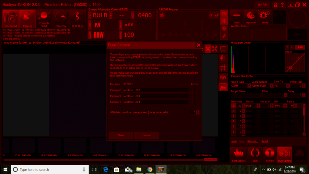

Ok, so with one camera on and connected and ready to insert data capture plan info......I plug the other camera into another dedicated USB port and click the button  "duel camera"  and come to this screen.  What now?    It shows spots for three cameras!   Im lost again!
Thanks!
Just now, skycamper said:
I can do that but the other camera didn't have a lens attached and it was performing in the same fashion.  One of the log files above might show that but I'll try again and send it over.
Ok, stop right there!
Dual camera ASSUMES similar setup.  If you have a camera with and lens and one without all bets are off.  Don't do that.
Dual camera tries to send the same camera command from the master instance to the slave instances, so if the master does not have a lens and the slave does and it won't know what to do with the aperture.
You need to have similar setup.
If you have two cameras with different setups, For example, one camera at prime focus to a telescope and a second camera piggybacked with a lens, then you do not want to use the Dual camera feature. The basic idea of dual camera is to have the master and slave synchronized so that they start and finish each image at the same time. That way the master instance can dither the mount between exposures. This won't work unless the master and slave have the similar optics, so the same exposure values (duration, f/stop, & ISO) can be used for both cameras.
If you have different setups (one with a scope and one with a lens) you can use the camera1 and camera2 instances of BYN, but not tie them together as master and slave.
