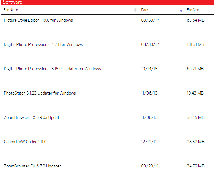

Looks like EOS Utility is not there (or EOS Capture like is was called back in the days).
Do you still have the disk that came with it?  If yes you should install EOS Utility (or EOS Capture).  This will install all the necessary drivers.

The Canon web site automatically detects your Windows version and shows software for that version. Change the O/S version to "Windows XP" to see EOS Utility 2.5.1 listed. This may install the correct driver for you.
