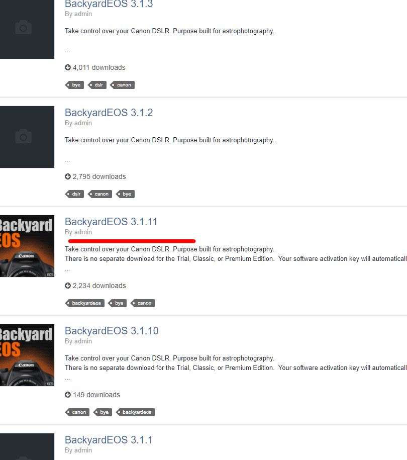

With Internet Explorer, I don't see the page that you included in your screen shot so this is a bit of a guess.
Click on the icon for BYE 3.1.12. When that page is displayed, look about 2/3s of the way down the page along the right hand side for the Next File control.

Thank your for your help and I'm pleased to hear 3.1.11 is still available but unfortunately I'm not smart enough to find it.:wacko:  I looked for the Next fire control you suggested but I can't find it even though it's probably right in front of me. Here's a screen shot of what I see when I click the BackyardEOS link on the downloads page. Can you see where I'm going wrong?
Thanks!
Ken
