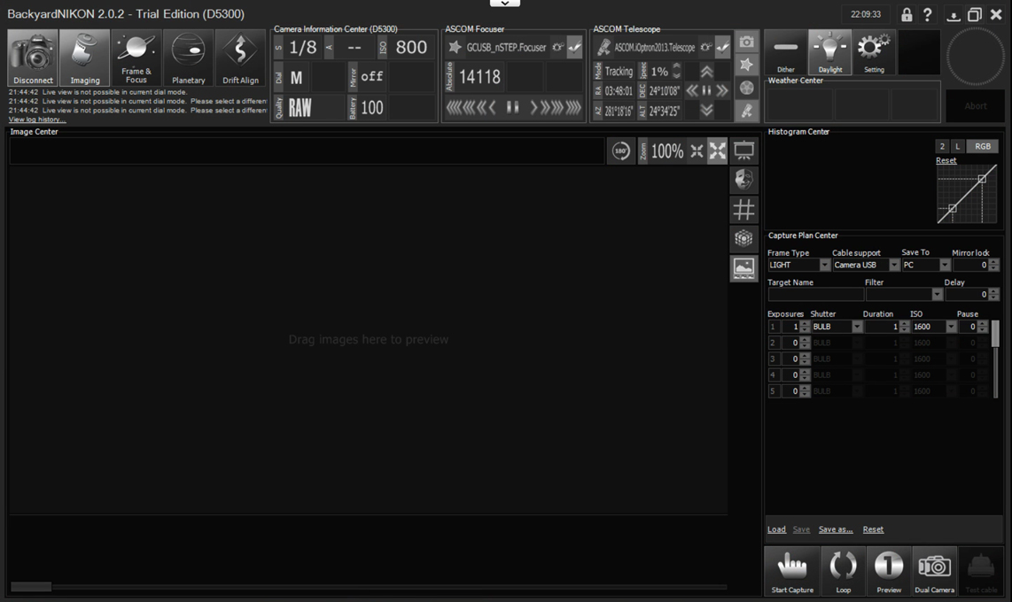

 I am newb with BYN.  I have ES127ED scope on iOptron iEQ45 mount and Rigel Systems NFocus USB focuser. I use BYN trial version to test with Nikon D5300. I see already there is topic on iOptron that cannot connect until new version. I also get alarm bell and message that there is no connect to NFocus but I know ASCOM driver installed and working separately. Is this normal to have no focusing?

What is the name of the focuser (from the ASCOM chooser dialog) you are trying to connect?
